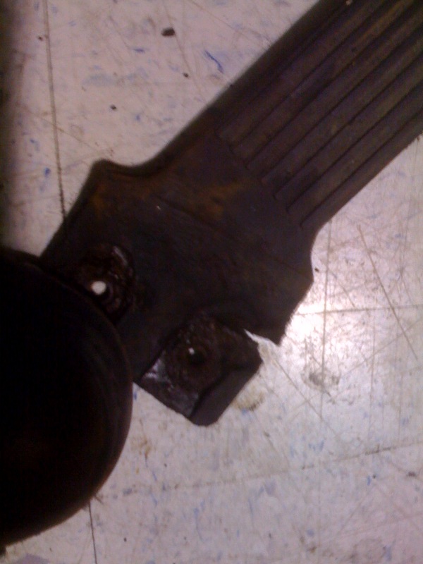

Last weekend I tried to drive it, but noticed the gas pedal was sticking. I spent a few hours removing this monstrosity:
Throttle arm was completely stuck.
I had to drill a hole between the bushings and inject penetrating spray. Then torched it for a bit and eventually freed it up. The gas pedal flopped around though because it's just a big rubber pad on these cars that pushes a rod, so I had to replace it.

Hey guys I figured I might as well post an update here. Since I was sick for a few days I got behind, but today I had a few hours so I pulled both carburetors from the motor. Those inner nuts were kind of a bitch, mainly because one of the studs was way too long.
Overall though, easy-peasy and I had the carbs out in about a half hour.
I took apart just one today. Both are actually leaking in the same place (the accelerator pump diaphragm was ripped).
Here's my "Carburetor Rebuild Workshop" (sponsored by Brembo and HRE):
Taking it apart into layers, it was clear that it was really nasty inside anyway:
Here's what was causing the gas to leak into the engine bay:
I spent a couple hours with carburetor cleaner and Scotch-brite pads scrubbing and cleaning up the exterior of the main housing, then cleaned all the gasket surfaces, blew everything out, and replaced the float valve. Finally I replaced the torn diaphragm and reassembled everything with new gaskets:
The rebuild kit actually did not include the top gasket, so I will need to cut a couple myself. It just connects the carb to the air cleaner housing. I also did not spend a whole lot of time on the "Redline" air cleaner lid yet that's heavily corroded. I'll either sand it down and paint it, then sand off the stuff that sticks up (making the Redline logo etc. chrome and the rest black) or just polish the whole thing.
