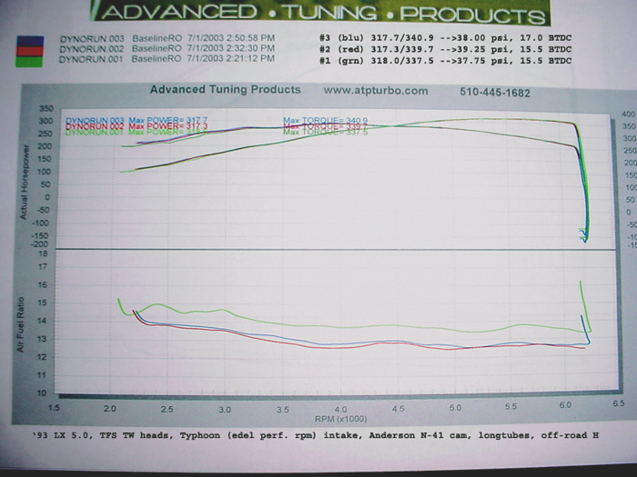

huh thats about ~9 hp more than my 302 made with TFS heads an intake and a cam through a Tr-3550
maybe a different dyno callib tho, seems about right tho based on track performance (11.9s @ 114-ish for 3050# raceweight)
and a little less TQ
super old dyno if anybody cares. For a streetable AFR-185 headed 331, I'd hope for 400 rwhp personally. perhaps it's in the tune/installation/a mechanical issue

How much timing were you putting into it?
I'm still fairly low on timing, and that's partially because for a road race engine, it would have to operate for a lot longer intervals than a car setup for street or drag racing. My timing is still at 29 degrees, and my intake manifold is kind of a restriction, since I peak super early. I'm going to guess that there is still some power to be picked up. I'm going to go with TFS R intake manifold (2200-7200 rpm range), and possibly tune it on E85. I haven't decided if I want to do that yet, since there are only a handful of those gas stations around here.

or your talking about total timing? I'm out of the scene for a while, the EEC-IV puts in (n) and I put in if you look at the top right of the chart there up to 17BTDC
I'm guessing thats like ~32-34 total timing but my brain no longer remembers the total timing the EEC-4 puts in (assuming ideal temps)
but hey man power is power, don't settle for 302 performance in that thing, jmho
I had full exhaust, and the only accessories being spun were the alt, waterpump, probably everything else was bypassed AND a pretty aggressive tiny ass crank pully, so considerable 'cheating' going on
something is really, really wrong though. You're down like ~80 HP imo
